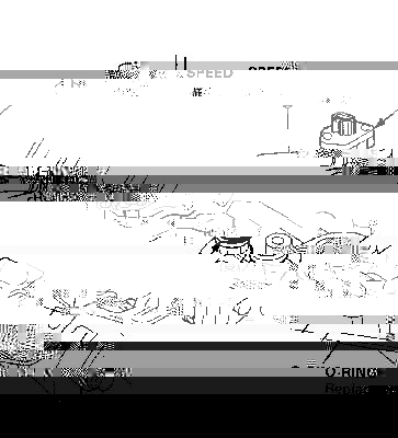

I finally got back to working on the car, it's all back together and runs great. Ther unknown bolt mystery has been solved. It was off the transmission speed sensor, the bolt that hold the speed sensor on the tranny. Good to finally have the car back on the road. My son is putting the miles on her again, Had a small oil leak the day after it was back on the road but it turned out to be the oil pan drain bolt washer needed to be replaced, I have a new washer on order but I replaced the old one with a teflon oil pan washer till the proper metal crush washer shows up from honda. Thank you everyone for your help trying to figure it out.

Well I was still digging around in the clutch mount/area. Hadn't looked at the first page of the manual install/removal....but here it is..... just like you said. Glad you found it. Nothing worse than "leftover" items when putting something back together.

That's the photo alright, as soon as I went to install the speed sensor I noticed I had no mounting bolt for it. Once I looked in the manual and saw the photo I knew I had found the right spot. Thanks again for all the help. Spiffyguido if I have my way this lude will be around for alot more years. Love the car and what a blast to drive.
