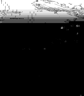

Sounds like maybe you got the air mix control cable on the back of the heater unit fowled up somehow, or you didn't plug the AC/heater control panel connector(s) back up all the way. I'm kind of leaning toward the air mix cable and/or the temperature control arm that moves the air mix cable when you slide the cold/warm air slide on the control panel. If it was working fine before you disassembled everything, then it has to be because of something you undid or loosened in the disassembly. All I can suggest is that you go back through everything piece by piece and make sure you have everything hooked up and that you didn't accidentally knock something loose or out of place.
In the header of the website there is a link for Manuals. Go there and download the 4th gen shop manual. Go through it in the heater / air conditioning section and look at the diagrams and troubleshooting areas. You might easily find the solution to the problem walking through those sections.

i forgot to put the braket and the screw back in, would that solve my problem? i plugged everything back in right, and didnt unhook anything as far as i know.....would putting that braket and screw back in make it work again? i know when i put the vents and everything back in, the heater/ac slider would get stuck in the middle and click when i pushed it to the a/c side....it doesnt do it now. but yea can u keep helpn me plz.

Always put everything back the way it was. Just a good rule to follow. Every bracket, holder, screw, nut and bolt are engineered into the design of the vehicle for a reason.
I don't know what might have caused your heat to stop working. But I want to lean towards the air mix cable and the heater temp slide.
The bracket and the screw do hold things in alignment and that could be just enough to make the cable or slide not work like they should.
Wouldn't hurt to spray some WD-40 in and around the cable linkage and the therm slide...... not a lot, just a mist.
Look closely at everything under the dash when you have it all back in place too, make sure the cable isn't getting caught on anything or being crimped or pinched or pushed into a bend.
That's about all I can tell you on this one.
Hope you get it right, it's getting cold out there!
